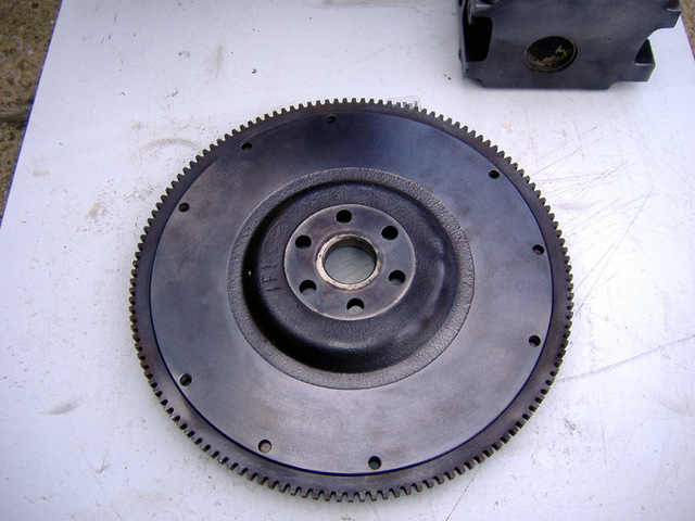

Does anyone have any pics of a mildly lightened pinto flywheel so i can show a machine shop. Ive seen pics of radically lightened ones with grooves
etc but i dont want to go that far.
I have it in my head that i dont need to touch the clutch face side at all. To the rear there seems to be a lot of material (guessing 10mm thick) that
sticks out beyond the ring gear, i assume this is what can be removed flush to the side face of the ring gear.

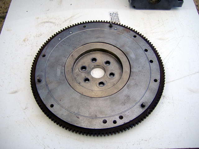

I have some pics that might help
'Back' of flywheel:
Clutch side:
I have bigger, higher res ones if you need them.

Thanks David, they look perfect. I assume the first one is the back of the flywheel (opposite face to clutch side). It looks like most of the 10mm or
so thick body i was talking about is removed.
2nd pic - clutch face side - has any been removed from this side?
Do you have any idea by how much lighter that one is? To be honest i dont know what they weigh as std and what a good target reduction is.

The first pic is of the side that faces the block.
It has had all of the rim removed, but i am not sure how much extra. The clutch faces looked like it had just had a light skim but nothing more.
I never weighed the flywheel, its still pretty heavy, at a guess I would say 5.5kg, perhaps compare that to your std one. I have a feeling they are
over 6kg as std.

I personaly wouldn't want to put my feet beside a bellhousing containing a lightened cast flywheel.
If you must then don't take any off the center dished area. It has to weaken it and there is little point as the effect on momentum is minimal.
Weight machined off the periphery is far more effective but I would limit it to removing the 10mm ring on the engine side like flak monkeys pic.
