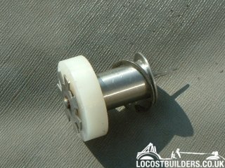

posted on 21/1/07 at 08:10 PM Reply With Quote
This is a picture of my sender when it was partially completed - it fits into the speedo cable hole, held in by the same circlip.
speedo sender
speedo sender
It's a steel toothed wheel that spins between a magnet and a hall effect sensor (which isn't in the picture - it's fitted to the lid that covers the wheel). The wheel has a tapered square shaft that goes into the hole that used to drive the cable inner. As you can guess, you'll need a lathe.
No dimensions, I'm afraid - I drew up some initial sketches, then modified details as I went along. It no longer bears any relationship to the sketches!
However, it gave some problems a while ago, so I was planning to investigate the ideas shown on this page. This looks like a fairly easy way of making a sender. In the end I fixed the original one so didn't take it any further.
I have also seen a web page that described how to adapt a London black cab speedo sender to make it fit a Type 9... but I've lost the link.
