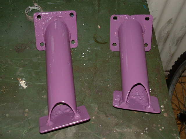

ayoungman
| posted on 20/1/07 at 11:02 PM |
Get the engine sat in the centre of the chassis. sit it on wooden blocks, milk crates or whatever, then adjust the height with spacer pieces of wood.
ensure the engine is on the centre line of the chassis.
You can then work out what brackets are needed to support the engine. I made mine, it wasn't that difficult.
"just like that !"

gazza285
| posted on 21/1/07 at 02:12 AM |
ayoungman and andrew-theasby, not wishing to upset you or denigrate your work but from the pictures you have posted I would recommend a little more
welding practice.
