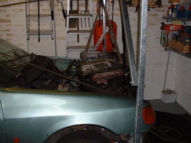

I used a nylon tow rope to lift my 2.0 pinto, fed through the lifting eyes and tied in a reef knot. I proved it's strength by hoisting the car
off the ground first

Hammerhead
| posted on 24/1/07 at 03:08 PM |
John.Taylor did you make your engine crane yourself?
