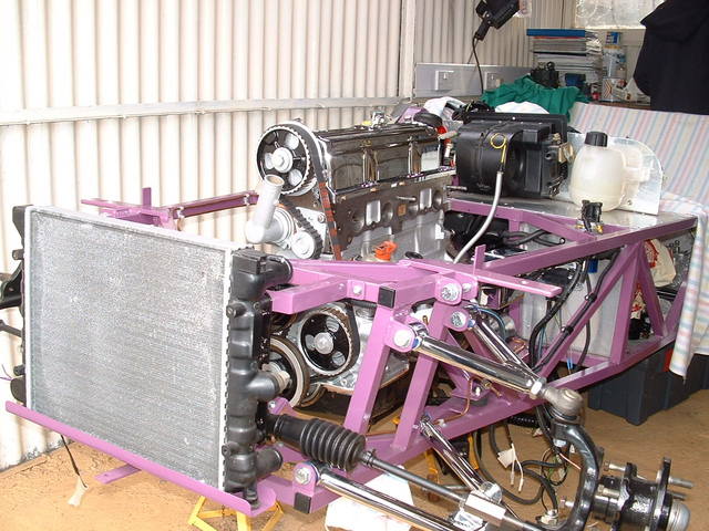

ayoungman
| posted on 25/1/07 at 12:28 AM |
Polo for me too. There aretwo or three different sizes of polo rad. They vary by about 150mm in width. Later ones I believe are more narrow.
"just like that !"
