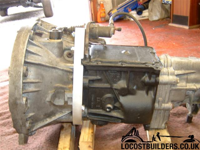

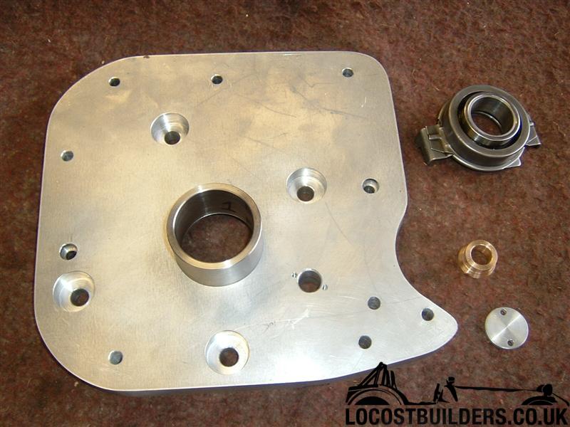

Johnmor
| posted on 27/1/07 at 02:49 PM |
I used a front wheel drive gearbox bell housing and made an adapter plate to mate it to a ford type 9.
Alfa 164 box and V6 engine.
Wasn't too bad, I cut the plate from 25mm aluminium and had it machined to suit gearbox.

Johnmor
| posted on 27/1/07 at 05:56 PM |
I bought a piece of 300x1200 25mm aluminium from Aalco.
Cant remember exact price, i think it was around £40.
I first made template out of 25mm MDF and used a router to machine it to see if it all worked, bolted together and tried the clutch. when i was happy
i cut the outside shape using a Jig saw and lot of parafin.
I then gave it to a mate who machined the aluminium to suit, also had to slightly modify the thrust bearing and make a spigot bearing from phospher
bronze.
