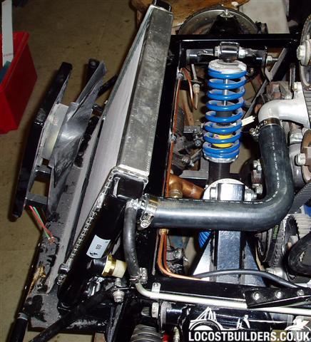

I've used a Polo radiator, and VW switch purchased from German Swedish French. When I bought the switch, the only query was, do I want one with 2 or 3 terminals. I went for the one with 2. Although my engine is a normally aspirated Cosworth, I think the Pinto may well run at the same temperature. Although the water temperature gauge is only a rough guide, the VW switch operated at about 90 degrees C.
