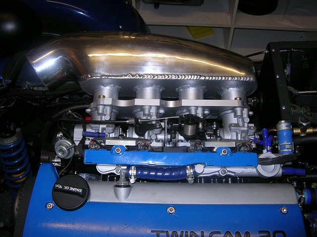

I've been trying to get my car finished for the past 3-4 months but have been let down a few times on price and delivery from some UK suppliers. So I took a gamble and ordered the cast alloy inlet plenum on Ebay.com from a guy in Thailand.
Needless to say I did what checks I could and noticed a lot of his customers seemed to be in the UK anyway. So I made use of the haggle option on the auction and got a decent discount on the asking price. Clicked the accept button and then prepared for a nervous wait for delivery. To my surprise the UPS courier tried to delivery it yesterday, I only ordered it last Wednesday! So I hung around earlier today and received the package.
As you can see its a simply engineered but robust plenum being both cast and welded. The velocity stacks are extended in to the plenum and the ports all line up. I don't expect it to blow apart on the rollers like some welded efforts I've seen in the past.
You'll notice it sticks out a bit which I was fully expecting but the inlet opening is definitely bigger than I thought. This is because it was designed for both NA and forced induction usage. As I'm using 50mm intercooler pipes I'll cut back and reduce the plenum neck which'll help a bit with room. I quite like the idea of some sort power bulge anyway just to give a hint of its potential!
PS The British made exhaust manifold however doesn't line up at the ports and angles too much away from the chassis. So that'll need some fettiling too plus the pipe after the collector is too small IMO but I knew that also but to get it altered to my design would have almost doubled the cost. My fault for not having the skills to make it myself.

posted on 4/4/07 at 01:58 PM Reply With Quote
that's one v nice setup
covering it with a bonnet seems such a shame. If it is SVA'd I'd leave it off.
I'm hoping to have triple webbers on my v6 and once through the SVA will dress up the engine and run it exposed.

bimbleuk
posted on 4/4/07 at 02:35 PM Reply With Quote
I know what you mean, the exhaust is barely covered anyway and I'm certainly going to consider leaving the plenum partially exposed!

Holy mother of god....that is a very sexy beast!!

Very nice looking installation, could eat your dinner of that
Was the plenum custom made to your design or is the port spacing fixed?

bimbleuk
posted on 4/4/07 at 09:41 PM Reply With Quote
Mike,
I initially thought I would have to buy a generic plenum and mod it to fit. So I was quite surprised to find someone doing one specific to the 4AGE 20V.
The guy trades as "NOZz HI-PËRFORMANCË PRODUCTS" on ebay.com. Mostly Skyline and Supra products from what I've seen.
