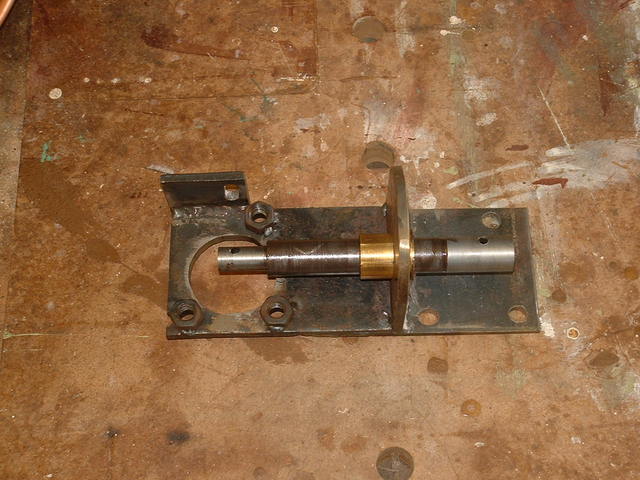

I have a couple of remotes one as came with my Tiger Cat and one that I made which uses the standard gear lever as on David Jenkins site
http://www.dwjenkins.plus.com/
only without the reverse detent and reverse light switch. Rescued attachment DSCF0038.JPG
