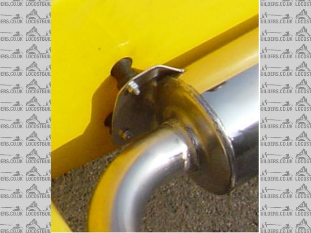

I drilled through the grp side and made a mounting plate attached to the chassis side box sections. Bobbins screw into welded nuts on this. Neat and strong ! Rescued attachment exhaust bobbin.JPG
