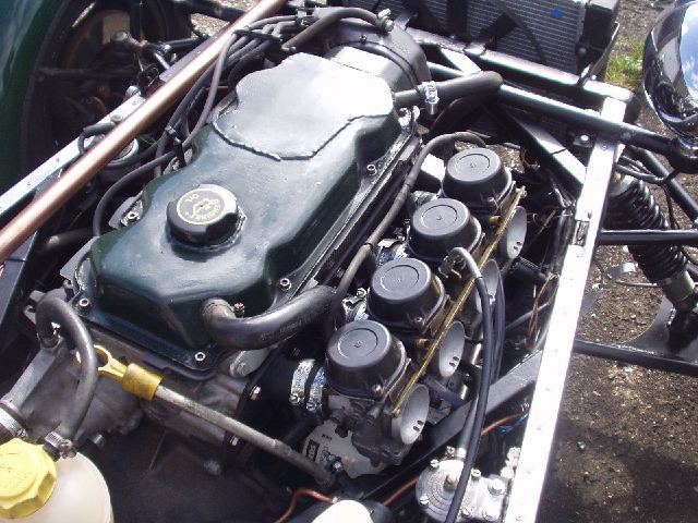

Mine are Suzuki GSXR 750 wn carbs , they are not too inclined which means they dont have to poke out of the bonnet.
As mentioned above Suzuki bandit carbs are nearly level.
Surrey Dave
| posted on 13/5/07 at 02:56 PM |
piccy
