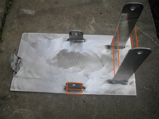

diff mount
hi ive mounted my diff in this plate ive made at work its all 3mm do you think it will be ok when its welded to the bottom of my track car.or do you
think it will bend
adam

IMO it will flex, but as to wether that's a problem or not I couldn't say. If there was a brace/cross bar between the front two longer
bits that'd make it much stiffer.

Not sure how it's going to mount in your car but IMO its going to bend. I agree a cross bar would help and weld another strip at 90 degrees onto
the existing ones.

It'll bend when you give it the beans...
So unless you're going to be very gentle with this new car I'd re-inforce it....

will it be welded to the floor pan of the car? if so it mite do
would be better if the mount points were made of thicker steel or preferably if they were angle or channel, as for the base plate if its fully welded
to the car would be fine as is probably but id personally want to add some diagonal strips on the plate between the brackets to prevent twist and
maybe add a few bolts as well in middle or weld to stop the middle area lifting and stretching away from the floor pan

Surely it will bend? The twisting forces as you hit the gas in first will fold the long arm I would have thought?
Are you mounting the diff upside down or hanging this plate under the floor?

Look at the way MK, GTS and other do it much simpler all loads carried in sheer .

ive just offered it up to the bottom of the car to see what its like.do you rekon it would be ok if i put some braces to the long arms off the boot
floor. the floor seems very thin i think i might have to run some box section across it

weld a piece of angle joining the two (four altogether) vertical brackets together, that way (at least) both of those will be suppirted and as they
should be in conflict with each other in a twisting sense that should in theory be like a double reinforcement(?)
also I would use angle instead of flat so that it imposed a certain amount of 90degree force into your bracket in general!

This sort of thing mkight help, obviously the long straps are the real problem, the short ones less so, but still think it may needd more suport if
your going to be giving it large

If you make the front arms out of 3mm x 25mm angle you'll get rid of most of the twist. Then add a X brace of flat strip across the forward
facing edge and it should be ok.
And yes, you're right about the boot floor. Being a saxo it was never designed to take any real force, so a few bits of box from the outer sills
and so on to create a frame wikll go a long way towards not twisting the rear end.

Weld a piece of box between the front two and some angle to the sides of the two side ones and drill through the original holes. Bolt it up to the
boot floor with a couple of 5mm spreader plates between the bolts to sandwich the floor
