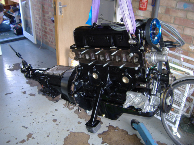

Just to confuse you, my block is a 205 and it came from a late carbed sierra (1989).
You can identify it by the large cast in 205 on the top drivers side of the block (see pic).
They were fitted with stronger conrods (ok for 7000rpm continuous and 7300rpm periodically - whereas the non-205 was rated for about 6800rpm
continuous, however unless you have a very good head and fat carbs, you wont have any useable power at these revs anyway).
The 205 is also better for the 2.1 conversion as it had slightly thicker cylinder walls. Though a non 205 block will still take a 2.1 overbore 95% of
the time.
If you have the choice, the 205 is the one to have, but it doesnt make a lot of difference really.
If your block is injection, it *should* be a 205 block.
[Edited on 25/5/07 by flak monkey]

mcerd1
| posted on 25/5/07 at 09:03 AM |
quote: Originally posted by flak monkey
You can identify it by the large cast in 205 on the top drivers side of the block (see pic).David
exept they normaly look like this:
yours is far to clean
flak monkey
| posted on 25/5/07 at 09:09 AM |
 Get the elbow grease out
