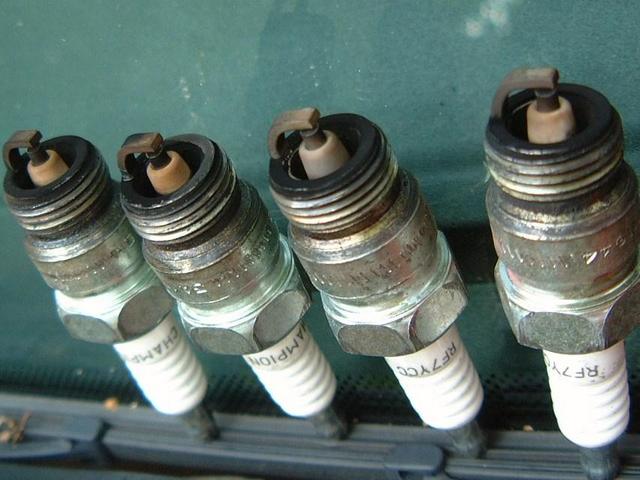

Got the car running quite well now after months faffing around with weber 40's off an old holbay engine.Not the best versions 34/35.Any criticisms or comments on the plug pics appreciated.Should point out that the two which appear richer are out of the right hand carb on each bank.My engine is inclined towards the front 4.5 degrees Rescued attachment 001.JPG

the soft sooty plug body is this normal when the middle appears ok

No problems there as far as I can see - classic biscuit brown colour with no deposits. Number 3 looks a little leaner but nothing to worry about.

The engine tuning book I have read suggested that you can't tune an engine on the look of the plugs. It's more that the plug temperature determines there state..
i.e plugs cold = deposits,
plugs hot = no diposits,
plugs to hot = danger of cracking etc..
i.e. you tune the engine then fit the apporate plugs that should then look "good". So there "state" only determines how far out of tune the engine is from its fully tuned state with apoporate plugs.

Unfortuneately - the pictures tells us very little - was this after 10 minutes idling or at full power for 10 minutes or at part throttle?
or a run round the block doing all the above.
The centre isolator and electrode just say that the plug heat is correct for preventing the plug fouling at whatever way you ran the engine before removing them - the outer ring that is more representative of the combustion chamber says that its too rich at that point.
Find a place where you can give it full power for 10 seconds or more and shut it off immediately and coast to a stop and remove them. This will give a better idea of what is happening.

MMMMMMMMMM the picture tells me you need to throw them crappy champion plugs in the bin and fit NGK No1 plugs

it is strange,but when the engine gets hot it does appear to be unstable on idle,ok on drive.Very stable idle all the way to max temp.Could this be plugs,is the fault typical of champion and why ngk are better
