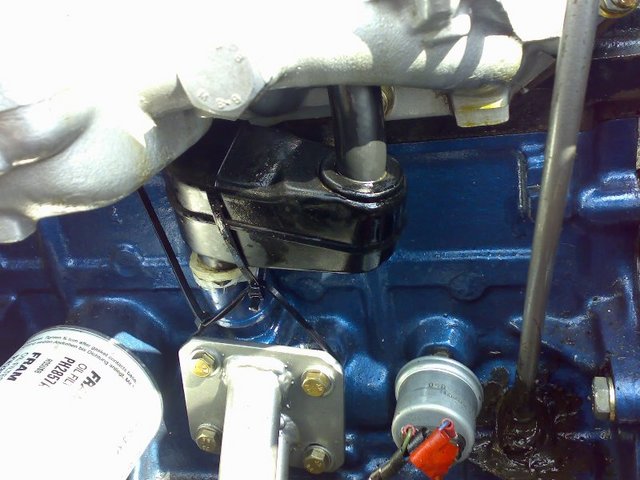

I did some work on catch tank last night and just taken some pics of my install at the mo -might help.
Pic 1 is the Cortina oil trap. I have made a mistake by fitting it on top of the sierra trap. Next job is to remove std sierra bit and fit cortina bit
direct to crankcase.
DarrenW
| posted on 19/7/07 at 03:06 PM |
Fitted cotina trap directly into the crankcase hole. I found that when installed it wrongly before i had pushed the pipe in too far - it was very
close to the bottom which is not good. Also i suspectthe angle wasnt good (it was pushed forward by the manifold) which would help to keep the end of
the pipe submerged in oil - again not good. Now it looks better and ipe is just entered into the grommet - no further.
