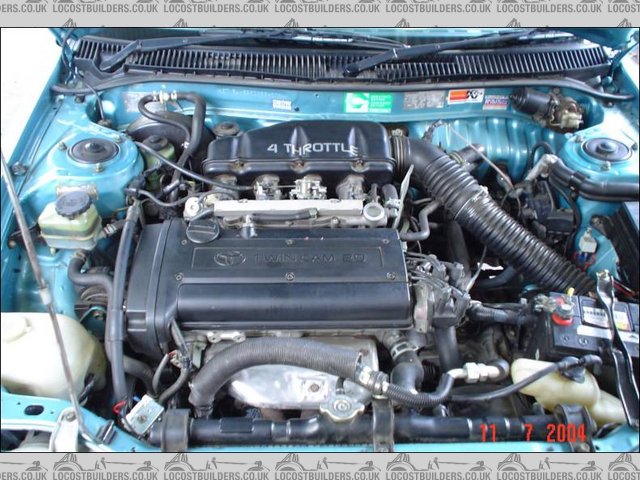

bimbleuk
| posted on 16/9/07 at 09:15 AM |
Having posted the above I realised your 90mm trumpets are quite long so the airbox idea may be more difficult.
have a look a the picture below. this is the Toyota engine with factory ITBs but minus the airbox. not the clearest picture but the trumpets actually
bend down and twist!! You look at them and think they shouldn't work but they are remarkable close to a straight trumpet. Put a sock on them
though and you instantly effect the power.
[img][/img]
bimbleuk
| posted on 16/9/07 at 09:21 AM |
Here's how they come!
  Standard 4AGE 20V engine bay
