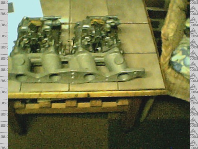

| posted on 21/9/03 at 07:02 PM |
The Dellorto one looks like this

| posted on 21/9/03 at 08:02 PM |
Sorry Matt, didn't know that. I picked this one up with carbs for £100 and haven't got round to fitting it yet. I think it's a
shorter one than the one on ebay. It needs a spacer gasket between the carbs and manifold face and I've not seen one. Now I know that it uses
the weber one I might get interested again.
cheers, Pete.
