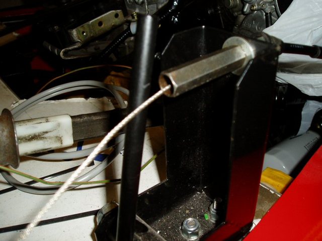

Now with explanation:
  Throttle for Coozer

| posted on 11/11/07 at 12:47 PM |
i'll try and get a picture later (i'm ill! haven't left the house in days).
Basically the bit of metal that goes round the throttle pedal and ......... (oh god, here we go again......)
hold on, ascii art....... copy all this to notepad on your pc
|Q
* Q = throttle pedal
* the lines around it are the thin metal
* the gap on the right is the hole i've drilled through the middle of the metal.
* the gap on the left is the small hole for the snap pin to go through the metal and throttle pedal. This holds the metal in place.
You then buy a 'thing' like this...
XXX
XXX
X X
X X
X X
Its actually a solid bit of metal with a hole in the middle that the throttle cable goes through. The hole from the bottom to the middle is threaded
and you put a screw in there to secure the cable going through the middle.........
you'll now notice that end on, (ie looking so it looks like this "O" the hole you drilled in the flat metal is about the same
size.
So, remove the throttle cable, slide the tube bit in the metal, line up the hole in the tube bit with the gap from the metal, slide the throttle cable
in, tighten the screw and .... hey presto.
(reality check, drill the snap pin hole last so you can set the throttle pedal position)
Final ascii art, from above (honestly cut and past into notepad and it looks ok / makes sense).
XXX
--p-----------XXX----
|QpQ ccccccccccccccccccc
--p-----------XsX----
XsX
sss
Where,
Q = throttle pedal
P = pin
- = thin metal
c = throttle cable
X = clevis pin thingy
s = screw into clevis thingy
