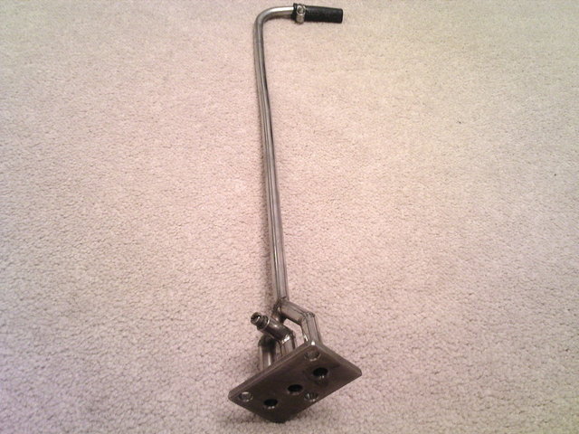

Monkeybasher
| posted on 6/3/08 at 08:36 PM |
Just found this. Not sure what role it plays although its to do with the manifold, is it for Idle speed control???
saigonij
| posted on 6/3/08 at 08:49 PM |
yea, that might be for the ISVC, although they are not normally 3 bolt holes though.... usually 2
Schrodinger
| posted on 6/3/08 at 09:08 PM |
A while back I bought a similar manifold that came from a Ginnetta and it had a separate mounting "ring" for the valve which mounted
between the manifold and the TB using the TB bolts.
It sits in my garage atm doing nothing.

Schrodinger
| posted on 7/3/08 at 02:49 PM |
I've found a picture but it's not up to much
