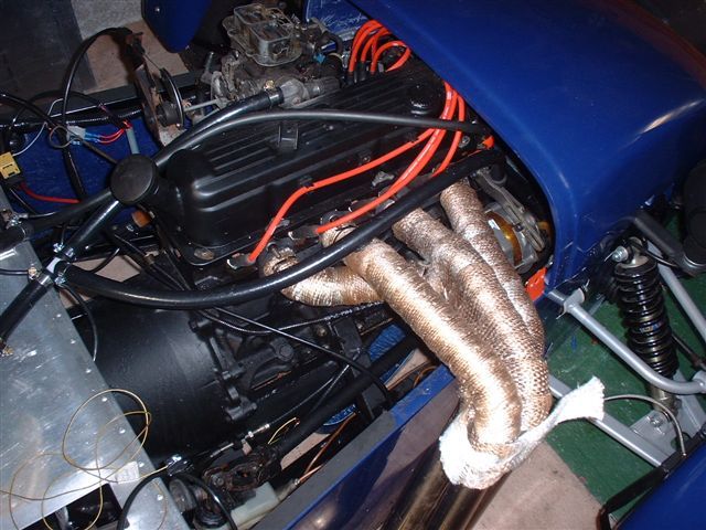

| posted on 3/11/03 at 11:14 PM |
My oil filler is at the other end but i'm sure i coulkd have got away with leaving it.
| posted on 4/11/03 at 12:04 AM |
I went for a bit on the side.
yours, Pete.

| posted on 4/11/03 at 11:26 AM |
Has everyone kept the fume vent (either by using the Pinto filler cap or by some other means)?
Just wondering if it'd be much of a problem for me to lose it!
James
CairB
| posted on 4/11/03 at 01:04 PM |
James,
Mine is an injection pinto that had a vent to the induction system beween the air mass flow meter and the throttle. I swapped the cap with one from my
1.8 Sierra that was lower but with no vent connection, just breathes through the cap. No problems that I'm aware of to date.

| posted on 4/11/03 at 04:50 PM |
Hmmm, but you do need a vent of some kind? Even if it does just go to atmosphere instead of back into the system?
James
bob
| posted on 4/11/03 at 07:51 PM |
My cap is the vent
