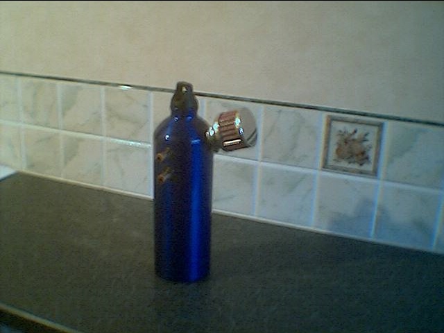

Cheap oil catch tank anyone ?
Demon theives oil catch tank circa £65
DIY water bottle one circa £9 !!!
Ali water bottle from ASDA £6 (drilled with 10mm holes)
JB Weld epoxy £3 (to glue tubes in)
Bits of copper microbore tube £...ppp
Intend to fix in the engine bay with a mountain bike bottle bracket.
Note: make sure you vent the bottle by either drilling some small holes in the cap. I am going to fit a small breather filter to one of the tubes.

givemethebighammer
| posted on 8/11/03 at 02:15 PM |
It's got no internals, just a bottle to "catch" the oily crank case breather fumes that would normally be fed back into the carb /
injection system to be burned in the engine. These fumes can lower the efficency of the fueling system so they are best routed to a catch tank for
later safe disposal.
Basically it is just a bottle that has a breather see attached photo

Northy
| posted on 8/11/03 at 03:48 PM |
So what are the other two connections for? One to breather, other?
Graham
scutter
| posted on 8/11/03 at 04:26 PM |
I was guessing crankcase and rocker cover, but be good to know for sure.
Dan.
givemethebighammer
| posted on 8/11/03 at 05:36 PM |
yup, that's it crankcase and rocker cover
