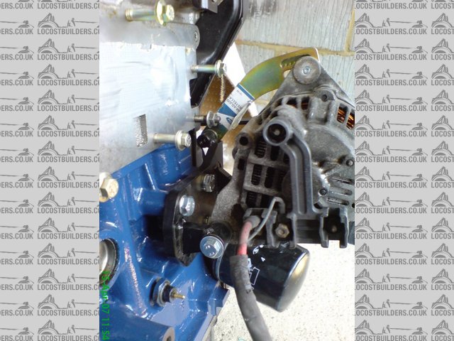

Brise alternator on a home made bracket, bolts in the same place as the original under the water pump inlet.

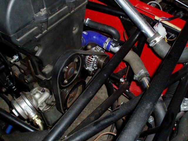

| posted on 29/3/08 at 09:49 AM |
Another view...
