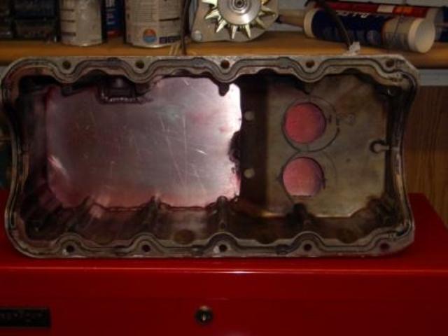

Hers a picture of mine. Cut it off level on the shortest side and then infilled at the back. Checket the volume and there is a negligable loss. It was
done by Avontech welding near Bristol. A god job which is oil tight. It also has a baffling system
Ian

Ian D
| posted on 28/5/08 at 06:17 PM |
inside
