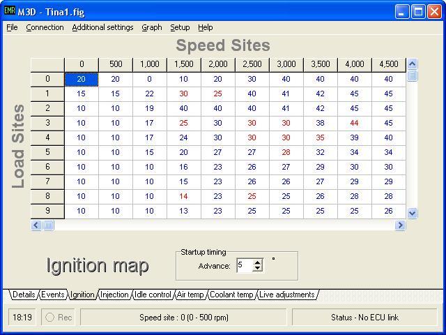

| posted on 14/7/08 at 05:18 PM |
here's a sample zetec ignition map from Emerald...
stevebubs
| posted on 14/7/08 at 05:22 PM |
Just had nosy and realised you've a V6 in that lovely motor (jealous)
Here's a cosworth v6 map..
stevebubs
| posted on 14/7/08 at 05:23 PM |
TBH I'd start with lowering the 600 loadsite to be the same as the 800 and see if that improves things...27 degrees is an awful lot for low down
in the rev range....may be too much advance...
