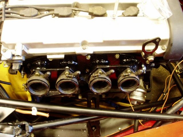

I just roughly angled the pipes in, and used the original bike carb inlets attached to plates on the manifold.
  inlet
  inlet2

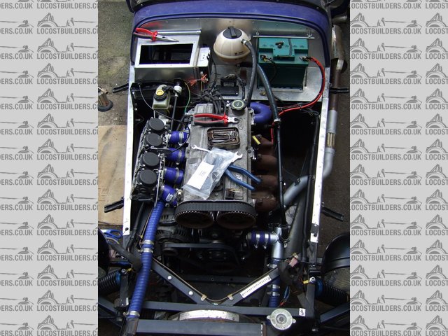

  view from top
