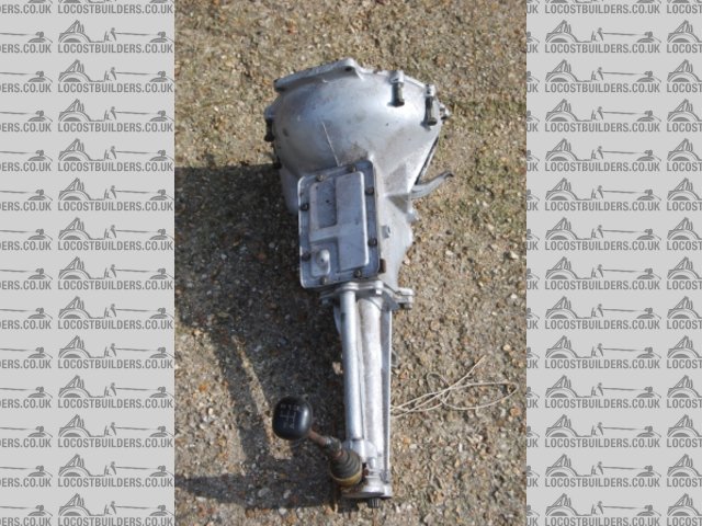

Need a little help identifying this gearbox:
  gearbox 1
  gearbox 2
  gearbox 3
Its a 4 speed, bolts to the CVH engine, has ford marked on the side, the splined shaft for the clutch plate has 20 splines (if i counted correctly)
and looks to be an inch wide.
The problem I'm having is I need to find a clutch plate that fits this and will go inside the clutch already on the CVH engine.
Anyone got any ideas and/or know good sources of ford clutch plates?
Thanks,
Chris

is that not a type e (rocket) box?
| posted on 3/10/08 at 12:06 PM |
http://www.burtonpower.com/technical_1/type_e_gearbox.aspx
i think it might be! can't really see the top cover in the link, but the rusty pattern on top seems to follow the pattern on your top cover

i think its a type 2 maybe......i think the type 2 was the one where you couldnt remove the bellhousing???

its a type 2,as fitted to escort 11/1300 etc,dont take too much power

Seconded.

of course its a type 2, i was just testing

type 2 as previously mentioned.
http://www.zetecinside.com/xr2/gearbox.shtml
heheh not sure about that, ive been putting 135 bhp through mine for about 12months now - although I do have some spare boxes lined up as you are
probably right lol
