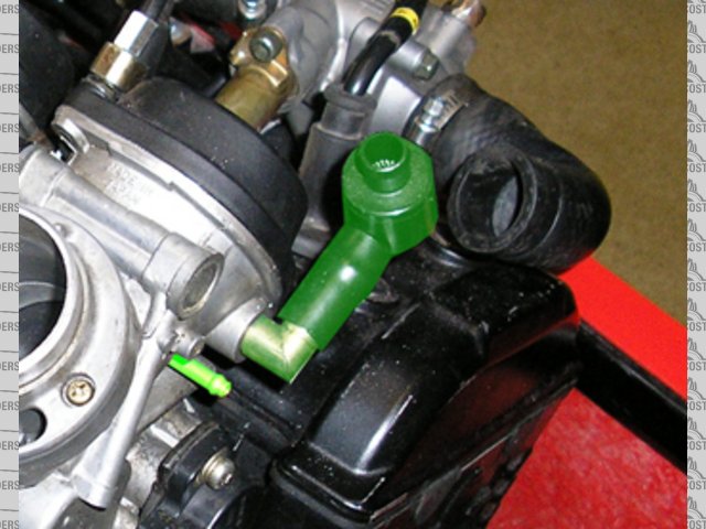

Ok, so here goes! - below are some pics of what I am not sure about on my R1 engine.
(Edited to add - carbed 4XV)
I have had my chassis converted to take an R1 engine and got it back recently, trouble is I don't have much of an idea about what the
hoses/cable/attachments are.
I have highlighted those things. In blue are hoses which I am pretty sure where they go. The green items are those which I am really not sure
about.
Please could you help me out?
James
Picture 1
  nearside smaller highlighted

picture 1 & picture 2 are breathers

Pictures 1 and 2: breathers. Mine came with little air filters, like those in picture 2.

smart51, thank you v much for your help - much clearer now Nearly time to start it up now!
