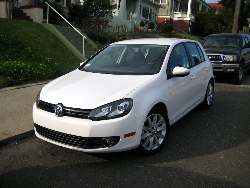

Sorry, it's a Candy White coloured Golf like this one:
http://lh5.ggpht.com/_VCiaIPIRiAE/S4NMh2u2AnI/AAAAAAAAJeQ/B4MCdqJQ84g/s800/IMG_2961.JPG
