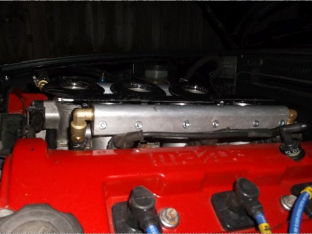

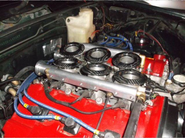

Thinking about trumpets, have you had much thought about the air box/filters yet? I know Claire has her CF air box sealing against the bonnet, but I would prefer to avoid going that way if possible. But equally, space is limited and it does save a bit of room. I've been toying with the idea of a separate filter for each bank but haven't looked into it much yet due to an impending house move.
Yeah, its going to be interesting I suspect. I haven't got my hands on the throttle bodies yet but clearance under the bonnet is going to be
tight.
My current thought is to make a smallish airbox fed via a cone filter from the rear but with a lid unlike Claires.
With my limited fabrication skills I will probably have a go with some aluminium and see what it works out like.
I have thought about individual filters or as you suggest 2 filters doing a bank each. I even started looking at if you could buy sheets of filter
foam so if desperate I could make my own. Kind of like 2 small pipercross style filters. After all they are basically a frame, a piece of mesh to give
the shape and some foam so can't be that hard !
I'll keep you posted once I receive the throttle bodies, hopefully today!
Rich
I do have a mold for an airbox which may be usefull - theres no inlet on it , and it would need modding above the rear linkage , but if you can use it
I can knock one up (as soon as I get some resin..........I normally `borrow' that from work but I'm not there at the moment
I've bunged in a complaint at Citylink - the `bodies were due for delivery on Friday
This is a slightly cut-down one on a Fury I did .

Originally posted by athoirs
[img][/img]
Rover KV6 300+ HP ...
[img][/img]
I think that's the first pic I've seen of the Mutch / Jolly car which gives a proper view of the engine installation.
Love that the engine is set low and well behind the front axle line.
This has been one of my favourite drivetrains in combo with the funky gearbox.

I've done some super-short trumpets and lowered the fuel rails with pico injectors - all done to make more space under the bonnet.........
It looks like I might have a bit more room? I measured 20" from the underside of the bonnet to the centre of the input shaft.
