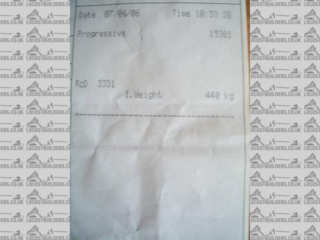

440 kgs wet, rear hoop and forward facing side bars, padded cobra roadster seats.
Eta, can do a Obama and show relevant paperwork if required.
[Edited on 21/6/11 by Jon Ison]

here, one pinch of salt.
Originally posted by Yazza54
Mine was corner weighted professionally
