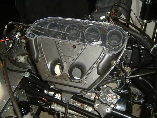

Here's my engine:
Pat....jpg)

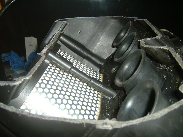

Hey all,
Just curious about the people that fitted this filter to a carbed R1? Did they retain the rubber trumpets?
I really want to keep the trumpets and was curious as to how this was possible?
I was thinking seperate air filter cocks might be an easier fitment?
Thanks for any advice.
Chris.
Obviously I meant socks!!
Not entirely sure that I could fit all the Big Brother contestants under my bonnet...
Chris.
Chris have you got your old air box if you turn it around and cut it down it will just fit under the MNR bonnet. You have to turn the trumpets round as well. I have had a go and it looks ok. Some say that it is a better to keep the air box than use the foam filters. There will be less induction noise for SVA noise test and it costs nothing. Bryan
I agree Bryan, hence the U2U for pictures!
I was just fairly unsure of whether the standard airbox would fit under the VortX bonnet.
Anyone else used air socks on their R1?
Or used the trumpets on one of these sausage filters?
Thanks,
Chris.
This is still under development as the bonnet is flexible it does just touch the top but as the top is flat I don’t think this will cause a
problem.
I have not tried it yet.
I will try it with some foam strips on top to see if it stops the bonnet vibrate.
Or I could cut a bit more off. Either way I don’t think I have lost anything by having a go. Maybe someone has some thoughts that could help. I think
I have seen pictures of one done before but cant remember where.
