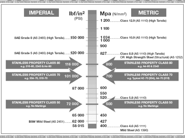

Mix and NS Dev, there's no such thing as M8 Grade bolts. You're confusing two entirely different standards.
The reason I mention this is there are real differences and the grading systems are not interchangeable.
The term "Grade" is used for imperial (SAE etc.) fasteners and the distinctions are Grades 5, 8 etc.
Metric fasteners are distinguished by "Class" such as Class 8.8, 10.9 and 12.9.
A common mistake is the substitution of Class 8.8 fasteners when Grade 8 is specified; people see the “8.8” marking and think it’s Grade 8. The
difference in tensile strength is 25% and could potentially spell disaster if they are mixed up.
Grade 5 is roughly the equivalent of Class 8.8 and Grade 8 is roughly the equivalent of Class 10.9.
I often use 1/2" fasteners for wishbones purely for convenience when using over the counter bushes etc. If I'm making my own bushes
I'll step the M16 rod ends on the front uprights down to 10mm and use Class 10.9 10mm fasteners throughout.
I only use Class 12.9 for the CV screws.

Thanks for pointing that out.
My results were arrived at by taking the properties of SAE grade 8 steel, (tensile strength 150,00 psi) and converting them to a bolt of 8mm cross
section. I see from your table that this equates to a class 10.9 M8 bolt.
