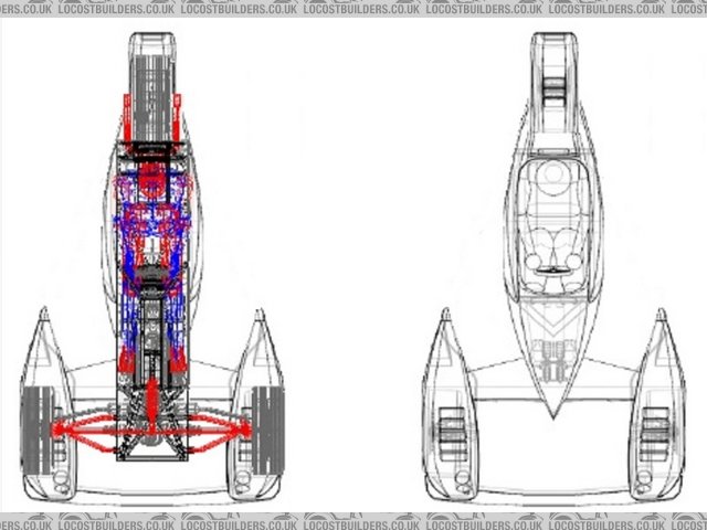

This illustrates the general arrangement of the main components

Will post more soon, would be interested to receive feedback and comments?
