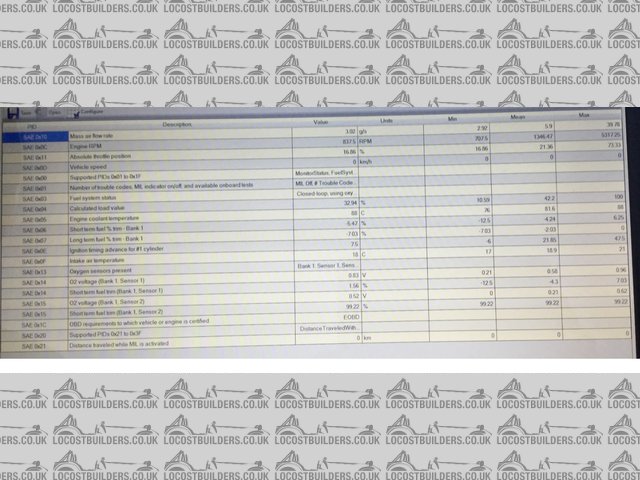

Have the odb2 connected. Can see the live data as temp and throttle position. But when i crank the engine is see no changes on the screen.
It should read an rpm so my guess is the ecu is not seeing the crank or cam sensor. Check the wiring and polarity. With no signal it won't fire the coil and it will cut the fuel pump.

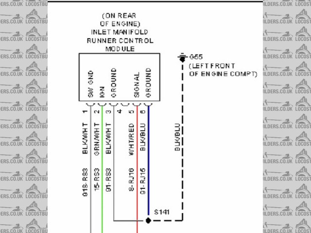

Only for a few seconds but that is because I still have IMRC not working (That is what I think). Only have connected the wires as you mention. But
struggling with the ground and switched ground leads.
First will make the exhaust with both sensors. i hope it will work when I will put these behind each other.
It will run with out the irmc but not at its potential, it will also give a fault code.

So I finally have it running. Stil only up to 20 sec because it is still without coolant.
When with coolant I will hang the Odb2 and see if there are any Faillure messages.
Keep you informed.

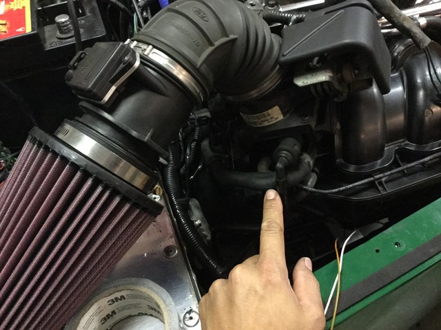

Have two questions and hope you can help.
1. The hose thet is inbetween the air intake and the airchamber below the cilinders (you had closed this part). I'm having a high vacuum that the
hose closes itself. Is that ok?
2. Trying to connect a digidash2 lite. Have to connet the tacho to the ecu. Read that pin 48 is for the tacho in many forums but that is only for the

Hose vacuum
2) Ok. The digidash2 does not support canbus. So will have to get it from the ignitioncoil I guess.
That's for the evaporation canister purge valve.
It's a charcoal canister that collects the fuel vapours from the tank and the ecu decides when to burn them off.
You won't have it so blank it off. The main reason for poor running will be an air leak.
Have you blanked of the brake servo port ?
The other one is the block breather. No idea why that would be collapsing.

View as much live data as you can via the obd2 port. If all sensors are giving sensible values most faulty running issues are down to air leaks. One I

Just have seen that the imrc is pulling the lever back when starting but drops it within 2 sec. Im thinking that I still have a vacuum problem.

So when its running you are seeing an rpm, tps %, Ho1 Ho2 (after closed loom ) Maf
Crank and Cam are polarity sensitive but if the loom is uncut you cant have them wrong ?

obd2 connected and it is showing changing values for all the sensors:
Yes, picture is of screenprint on hot engine
readout on hot engine

other thing is that your connector picture does not correspond with my connector. So cannot confirm which of both is pin 1.
And this is the same with the connector of the IMRC. So have based the connections according to:
imrc connection
I had mixed pin 1 and 3 on the connector of the IMRC.
Only on startup the IMRC is pulling to shortrun mode. After approx 1 min it shuts off and goes back to the longrun postion (so car shut down

Ive been asked a couple of times about the imrc plug wiring that I missed from the original post. Due to the plug being fairly unique to just a few
models there is little info on the net so I had to find one and trace it back as I could not find my original notes.
The plug has odd numbering.
1)green/white 12v.
2)black/white chassis earth.
3)black/white ecu pin 12.
4)white/red ecu pin 3.
5)black/blue chassis earth.
6)no connection.
Hope this helps

1. The hose thet is inbetween the air intake and the airchamber below the cilinders (you had closed this part). I'm having a high vacuum that the hose closes itself. Is that ok?

Hi Big_Wasa. Great work. i have been working through your guide and the ford wiring stuff, so far so good however my fuse box loom was cut when i
received it and i cannot find the IMRC control plug or wiring! whereabouts is it located on the loom do you recall?

Hi, from memory there is two really big square plugs near the base of the fuse box, grey and the other brown. Joining into his is the imrc plug on its
own, fairly long lead from memory around 30cm.

Thanks. Ive almost wired in the IMRC that arrived today. Must the cable end be connected? I have bike throttle bodies. Was it used to reduce air flow into the inlet manifold when the flap was closed? A sort of choke?
It needs to pull somthing or it will log a code and peg it back. Make a spring so it pulls that.
It’s a dual stage inlet manifold not a chock. So it makes the runner length longer for more torque and shorter for more revs.
Aaaah. I see. It has a spring built into the main body, but I will add one in. It’s very interesting.
Yes its sping loaded, just replicate it. So the ecu thinks it knows if the manifold is long or short.
From memory its short at idle, long in the midrange going short again at the top.

And the Ford Vacuum Solenoid Valve Intake Manifold Runner Control 4M5G-9J559-NB? Is this necessary?
If its what I think you mean then the st170 doesn't have one. Although it's badged as a Duratec it is a Zetec.
What your referring to looks to operate the swirl flaps on a Duratec.
There is a canister purge solenoid. This vents the fuel vapour from the tank, into the charcoal canister then via the solenoid into the inlet
manifold.
With out it, it will give a fault code in the ecu. This may or may not affect performance.
You can unclip the canister from the solenoid and just plug it in. You could replicate the load with resistors. You could ignore it and see how you
get on.
I've done all three and the first option is the easiest.

The solenoid just unclips from the canister purge valve. Just plug it in and the ecu is happy. On that front any way. The ecu can tell the circuit is live and drawing current and that’s why it could be replaced with a dummy load.
I am not sure what you mean by the rest.
There will be other wires in the dlc for other non engine diagnostics
I have the canister with the two pin connector to the top. I did not know what it was!! Tried googling the numbers with no info supplied. I gather the solenoid connection must be near the inlet manifold. Which bit of loom if you know please?
Thanks for the info. Do I need to add chassis earths to the ecu. The brown is common. Does it connect the the car body or engine in anyway, or is it just in the loom.
It sits on the bulkhead and connects to the inlet manifold with a hard plastic pipe. And another pipe to the fuel tank. The plug will be on the engine

I have sussed out the fuel pump, at least, it primes when ignition is on. I have practically everything connected already, and so to just do the connection from your video to get the flashing led right will take forever to disconnect everything and then reconnect it all. Without ignition on it flashes slowly. with it on very quickly. My obdb2 sensor is about 5 years old. Is it up to the job? With connecting it (with the correct port wires fitted) it scans all the details but just cuts out and restarts when I try to test for faults. Any ideas why?
For OBD2 read DLC
I have three obd2 tools one is around five years old one is well over that and they all do the basics just fine.
The light flashing quickly when powering up is the immobilizer being triggered.
It's very low power and is sensitive to position.
Power or earth fault to the antenna.
Power or earth fault to the ecu.
Send and receive the wrong way around.
You don't have to strip the loom down the point was the other circuits or lack off won't affect the immobilizer working or not.
Some times when the immobilizer is triggered and there is no fault ie the key was not close enough then you may have to disconnect from the battery to
clear it.
[Edited on 3/7/18 by big_wasa]
To add one point. you havnt purchased a flashing led have you ? It should be a plain led with around a 600 ohm resistor pre wired ( depending on colour).
Ahaaa. It may be. I think I have some others that do not. It has a slow rhythmic flash until ignition is on. then it goes very quickly.
I have connected the O2 sensors now as well. They are the same pre and post cat on this car year.
The reader can tell if the engine is cranking at 250rpm so I guess the crank sensor works.(No spark though). It reads inlet temp and coolant temp. It
reads others that make no sense to me with my limited knowledge.But, the reader still just switches off if I press enter to check for faults.
The pump is priming. I have used as much of the standard loom as possible and feel that I have not connected something like chassis earths properly.

I am making a fundamental error and its frustrating. Is there any way of checking the ecu itself just in case this is the problem? It may have been
blown and sold as good.The car it came from was running in limp mode and had a fault, though I cannot find out what it was. The breaker did not
mention this. I found out on thnet using its registration number which I insisted on having.

Also, a wire from the knock sensor went nowhere as well as one from the IMRC. I will trace all the wires and work them back to their correct

Can anyone recommend the best obd2 program? Forscan? I have the elm327 unit (not chinese) to link up with.

Forscan is great but overkill for little jobs I use an app called Torque on my android phone with a cheap clone elm dongle.

Need to get it running with coolant plumbed in and try to get my obd dongle linked up to the ecu / phone properly to check for any issues but I'm

I have the st 170 ecu completely wired in now.Problem: while it starts and fires easily, it idles way too fast. About 2700 rpm. I have fitted the GSXR
750 injection bodies, using the standard injectors and rail, the standard air idle control by using a small bore (+/- 4mm) 4 port manifold that has 4
pipes inserted into the throttle bodies inlet manifold side of the butterflies. From this little manifold, one larger tube runs to one of the air idle
controls ports. The second port next to it runs a tube into an air filter.
It is the same as this Google image:
https://www.s2ki.com/forums/s2000-forced-induction-142/itb-turbo-441249/page2/#&gid=1&pid=2
I have blocked any possible air leaks including around the injectors with a silicone sealant for car engines.
Can anyone think of a solution please?
Remove the idle control valve. You won't need it on the bike itbs as they will be set up for idle on the screws. And 're check for air leaks. You will also need to balance the itbs.
Thanks. I will check again and run it without the idle valve.
The itb's are already balanced and barely open.
Will the ecu not control the idle anyway using fuel enrichment?
What about a choke?
I have a manual choke setup and it makes no difference at all. I disconnected it but can easily reconnect it.

I've got my engine running nicely but can't for the life of me get the obd to work. I have wired it as per your diagram but still nothing. Any ideas what could be wrong?
You probaly wouldn’t even need the can wires. Just 2+10 the power and two earths.
From memory the two signal wires could be twisted in a helix to cancel interference.
I've got the wires twisted and tried it with and without the CAN wires with no joy. I might try a USB reader instead of the cheap bluetooth one, only thing I can think of.
Try and borrow a known working one. One of the very cheap hand helds is ideal.
An old bluefin unit gives a high level of information.
I bought a wifi obd reader off Ebay after reading about problems with the bluetooth ones.....and still no use.
Fortunately my neighbour mentioned that he had a diagnostic reader. Plugged it in and it worked a treat. It did find a couple of error codes, one with
the MAF and one with O2 sensor circuit. I'll need to look into these over the weekend.
So I'm getting a P0135 O2 sensor heater circuit, bank 1 sensor 1 fault. Wonder if I need a new lambda sensor.The MAF fault didn't return
after I cleared it.

The Imrc Module
The pre and post catalyst heated oxygen sensors
The inertia fuel shutoff
The evaporative emission canister vent valve
the central junction box
maybe some other things but I don't know which!

For that i can really say that FORScan is a good tool with diagnostic, i can see a lot of values, much more that with standart obd tool.
I logged the Values with the engine in the car, so i can compare between the OEM values and the Values in the Wesftfield.
So if i have much less ignition advance (for example) or lot less mass air flow, i know there is something wrong with my install.
I hope you can understand what my ideas are

Well, i dont know if the ECU completes the Adaption process where it "learns" all the MAF adaptions, idle values and so on.
Did you ever look if the ecu has completed the adaption? My Thoughts are that the ecu must have differenct vehicle speeds where it does the adaption
process, maybe i am wrong? Did your P1000 ever disappear?
I fitted now a Aftercat O2 sensor, i will try if it the p1000 disappears with the "Abtriebswellen Sensorsignal fehlerhaft" (Dont know the
english words for it) But when VSS is disconnected, this error appears.
For me this are the only 2 P-Codes in my ecu.

My ST 170 run's well since 2 years now ...but I have a problem with the IMRC
I 'll open the box this week end but I think it's broken
So, I 've a question: were can I find an IMRC . Can you give me a website adress ?
Thank's for your reply
Jean
They are fitted to the 2.5 v6 Mondeo as well. There are also guides on YouTube on how to fix them.
