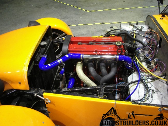

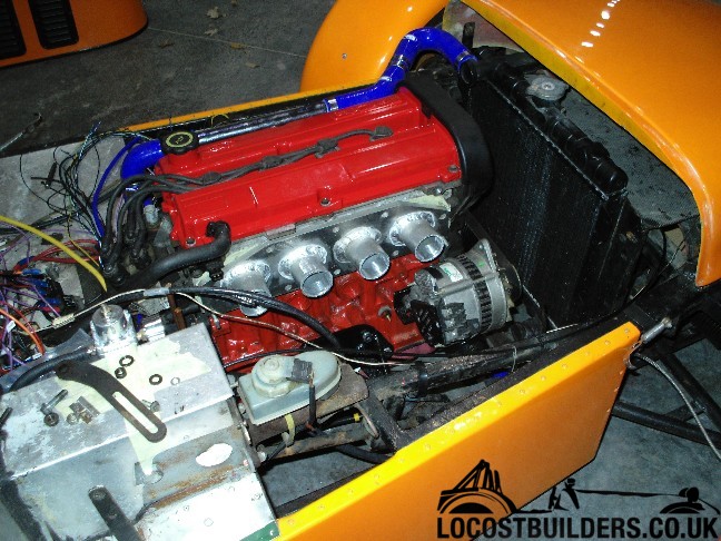

Steve Hnz - I've posted photos to my archive.

Wyn, magic photos, beautifully clear & very neat job, any others you care to post will be drooled over!

I'll post more photos when I get a chance. The most impressive bit (which I didn't think of!) is the clutch pullrod mechanism - it does away
with the hassle of trying to get a cable to fit and bend in a tight space: it's really smooth as well. I'll post photos soon.
Wyn

I am getting along quite well with my conversion but though I should advise caution on the inlet side.
I have had to shorten my inlet manifold as there was not much gap between the rear TB and the brake Master Cylinder.
I will soon be sorting out the spaghetti wiring of the MegaSquirt.
Don't worry, I do intend on wrapping the other primaries but I ran out of wrapping.
