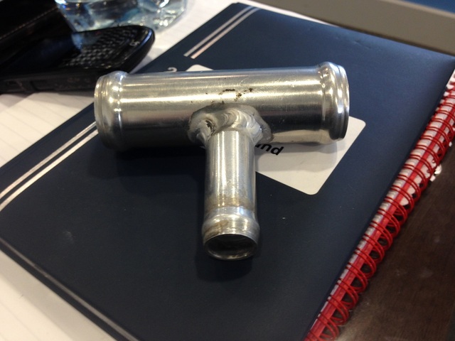

Bought a T piece pipe for the coolant system off ebay, but i was less than impressed considering it was quite expensive.
Crap T Pipe
Crap T Pipe
The pipe was all bent and the smaller pipe wasnt drilled out properly.

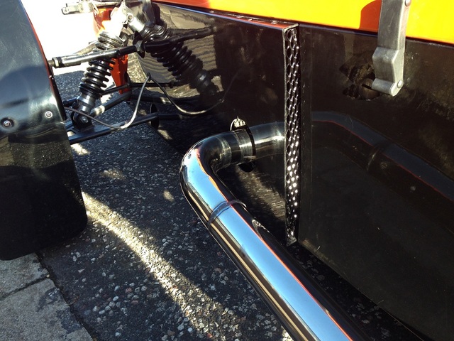

Got my mate to tig up the exhaust last week, so fitted it this weekend. Fitted perfect first time, right slap bang centre of the cut out in the side
panel too. Really pleased how its turned out!

Small update, couldn't find a t - piece the right size (32mmx18mm) to join that surprise pipe up to the bottom/water pump hose so I had one made
I already had the individual pipes so I cut and shaped the smaller one and drilled the larger pipe, then my friend tig'd them together for me.

Forgot I missed a step, Faired side panels... I also meshed them to hide the chassis behind.
