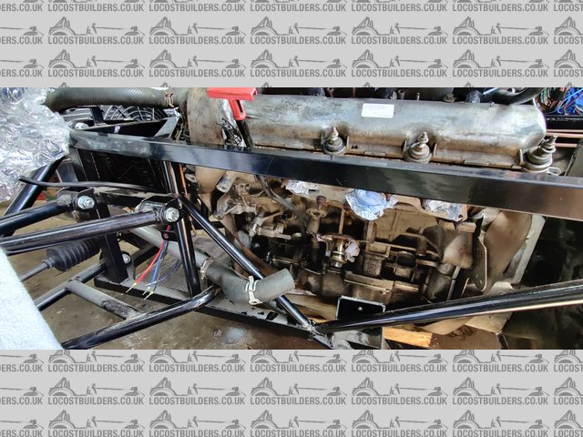

Although this thread has moved away from its origins and gone to turbo AJ30's . I am fitting my AJ30/RX8 combination into a MGB. Out of interest the 65mm (actually more like 67mm) from a late 90's Mustang GT or Crown Victoria fits perfectly on a ST200 manifold, even the TPS plug is the same and I got mine from a very low mileage car for the princely sum of £25 including shipping from the USA!
A bit of thread resurrection!
I've managed to get the AJ30 into the engine bay, but I can't see any way of getting an alternator attached. It it possible to rotate it 180
degrees and have it hanging off the front of the engine? Anyone seen that before? I think that may be my only option unless I get into modifying the
chassis right next to the front suspension.
Also I'm going to need a smaller / remote clutch master cylinder. Any bright ideas for a good small one?
Thanks all!

These pictures should help explain the issue. It is difficult to explain with photos, but the passenger side mounts are obscured by chassis and the
belt routing would be a nightmare. There is room at the front, but presumably the alternator would rotate the opposite direction and brackets may be
a sod.
Alternator location
Alternator location 3
Chassis is loads different to the old one!
That angled brace bar will need removing by the looks of it,and rework the brace once you've got a alternator mounted.
You realise you've got the later engine there with the more complicated VVT?
Early ones just had a solenoid to advance the inlet cams,which is easily controllable by a output from any ECU.
Yours will need a ECU with proper VVT control from what I've seen
Yes, I worked out that it was CVVT after I bought it. I have some ideas for ECUs, if not I understand that it is possible to remove. Alternatively I
will get a different engine.
I am reluctant to do too much chopping of the chassis, especially close to the suspension mounts. Do you think hanging the alternator out the front
won't work?

Ive found another difference with the CVVT engine that I didn't know about (or had forgotten). Half of the passenger side cam cover is taller so
the inlet manifold solution that you all have worked out won't work without a thicker adapter plate. Accommodating this under the bonnet with
drop the sum a bit further out of the bottom of the car and it is all ready quite low.

It only bloody fits! :-D
Engine Fits
It is tight though...
Gearbox tight
Current head scratchers to sort (any ideas?):
Clutch master cylinder needs to be 90mm max, current one is too long
Reverse switch on the gearbox can't be installed as the 'box is hard up against the chassis
Ground clearance is about 50mm
Once I have nailed those I can move onto engine mounts, exhaust, clutch, flywheel (and compatibility with the starter), engine management, prop shaft,
oil filter and inlet manifold spacers. Then the engine swap aspect is complete and I can continue building the car!
