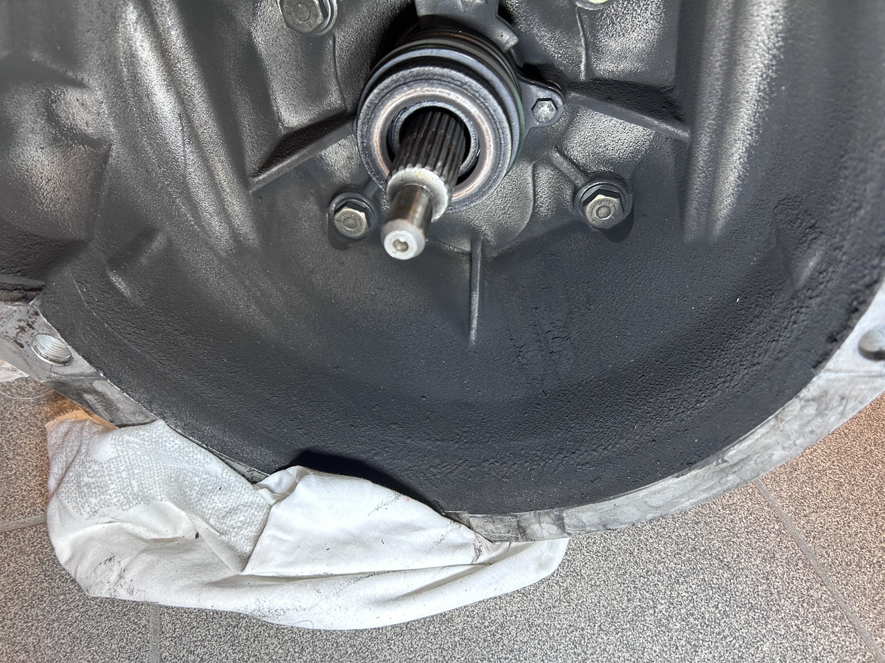

Running a Type 9 gearbox in my westfield. Itīs connected to a VW 1,8T (AEB).
Due to a couple of leaks I have to check and replace some seals.
I disconnected the gearbox from the engine today and found leaks between the gearbox and the bellhousing.
I think the bellhousing was bought from Tiger sportscars i Holland 10 years ago.
Now I need to know if anyone kan give me part-nr or dimensions of the seal in the bellhousing?
I also need to know if I can unscrew the layshaft bearing stub to replace the silicone.
THANKS!

The seal pictured is part of the release bearing that is fitted to your bellhousing, this seal is only used for the original gearbox that the release bearing is sourced from (iirc looks like it's from an mtx75), it does nothing useful in the type 9 setup.
I had a leak in my Tracsport type 9 last year, it was mainly the gasket behind the front nose cover, I had fitted a cometic gasket kit when I built up my Tracsport box, turns out the cometic nose cover gasket is slightly too thin for the application, and started to leak after a couple years of use.
The shaft seal inside the nose cover was also leaking a bit as well, your shortened nose cover will still have this seal fitted in the side facing the gearbox and is a potential source of your leakage. Something i haven't found is a good quality replacement seal here, between several different rebuild kits I had, they all had a poor quality copy of the original seal.
The layshaft spindle is a full length shaft on the Tracsport box, not a stub shaft like a v6 type 9 , when I built up my Tracsport box I had to gently heat up the casing to give enough clearance to fit the spindle through the bore in the casing (iirc 0.10mm oversized), this is by design to eliminate any play when in use under load, but may make removal quite difficult without stripping the box completely, I've not had to do that so don't know.
Due to this, I would have thought it very unlikely that oil would be able to pass through that bore even if there was no sealant used. The threads for the bolts may be able to pass some oil through though if not sealed as I'm pretty sure they go right through the casing, I used threadlock on those bolts as well as nordlock type washers.
A small amount of oil will also find its way out of the selector rail at the top, if the bellhousing gasket doesn't seal fully this can creep into the bellhousing as well.

I donīt really understand, inside the bellhousing itīs completely dry.
Thatīs of course totally true - I believe the release bearing comes from a Mondeo.
I changed both thoose on my former type 9 box in my old Seven and thatīs was also the plan to do on this.
In your opinion, where can I but the "best" gasket and seals?
Sounds like I should let it be as it is. Could I loose one screw at a time and just add a bit of Loctite or is it to risky?
Appreciate your help - thanks once again!
