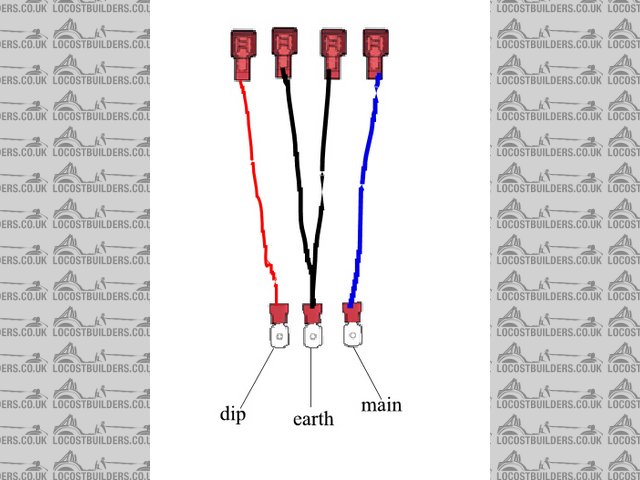

| posted on 2/10/04 at 10:08 PM |
So what you want is 3 male spade connectors. You can use insulated female spades straight onto the bulb terminals. They just won't be in a block
so you'll have to put them on individually but that's no problem. Something like this or a variation of it would do it.
phelpsa
| posted on 3/10/04 at 07:57 AM |
That was what we were going to do if I couldn't find a connector, so I think we will do that.
