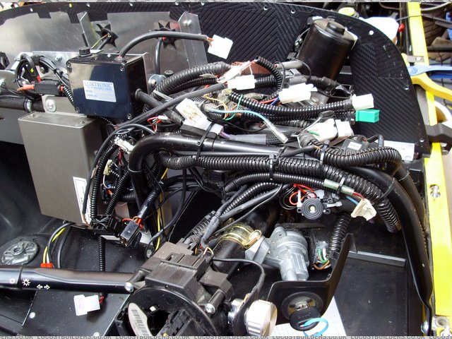

I used Motorbike buzzers fitted under the steering cowl, easy to fit, line in from the indicator circuit and an earth wire
You can see one in this photo, they are fitted back to back.
