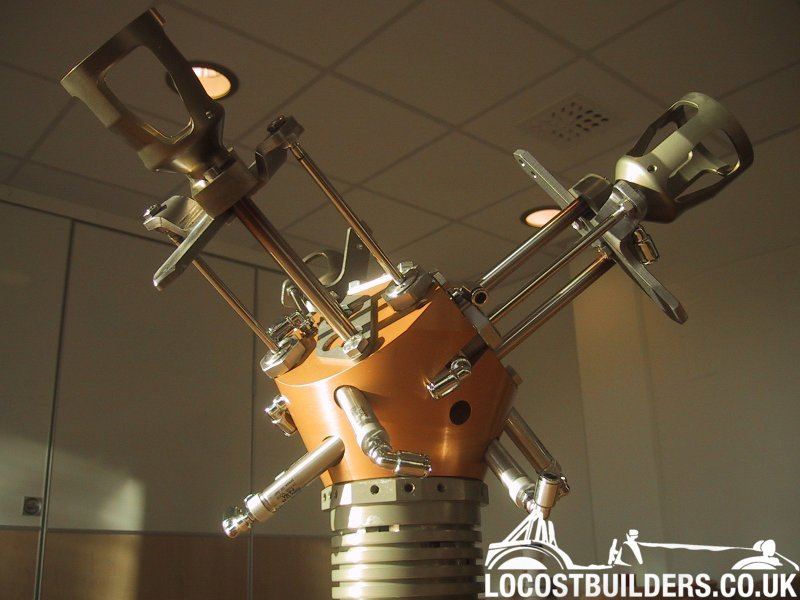

http://www.locostbuilders.co.uk/upload/Img_3204b.jpg
Above is the kind of thing I design .. if there's aluminium on it, It's anodised. I spec both hard and standard anodising, and never have
I heard of material being lost... then again, we pay through the A*se for it... So I expect it to be a good job!!!

indykid
| posted on 21/2/05 at 12:54 PM |
WTF is that thing?
looks like a WMD

nick baker
| posted on 21/2/05 at 01:43 PM |

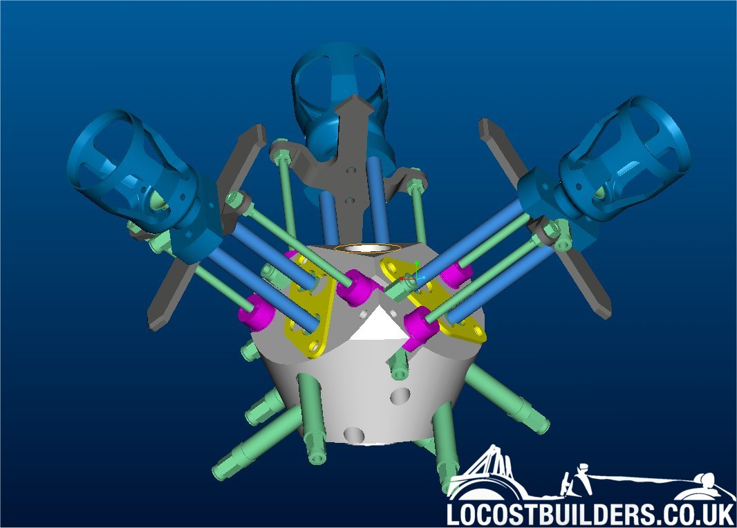

It's this... but a few thousand Euros later..
http://www.locostbuilders.co.uk/upload/tophandling_NJB.jpg
spose I Could tell you.. but then I'd have to launch it at you
