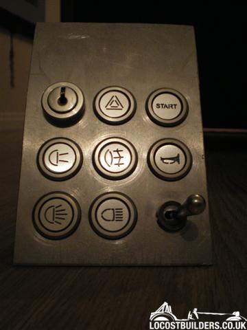

Avoneer
posted on 6/3/07 at 11:23 PM Reply With Quote
Stepped drill bit...
Hmmmmm...
Mastered it on my third attempt.
They do tend to wander if you try and use the full length in one go.
Started off with drill bits up to 12mm and then the stepped bit.
Perfect...
Panel ready to be riveted on.
Cheers everyone,
Pat...
