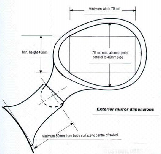

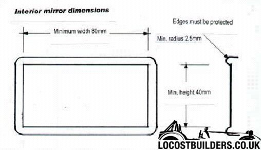

Can you confirm that these meet the area requirements etc for the sva?
If they do I'll be purchasing a set...

I'm not sure what the SVA regulations are can you let me know? I'll check them out. They are very small race car mirrors, so they may be too small for SVA, but, as a friend of mine said yesterday what passes the SVA doesn't have to be what you end up running on the road!

any interior mirror must have a reflective surface large enough to accommodate a rectangle 40mm high by 80mm wide
any exterior mirror must have a reflective surface large enough to accommodate a rectangle 40mm high by 70mm wide
and at some point must be 70 mm high, measured parallel to the 40 mm side
interior
http://www.locostbuilders.co.uk/upload/int_mirror.jpg
exterior mirror
http://www.locostbuilders.co.uk/upload/ex_mirror.jpg

They meet the 40x70 and the 40x80 but they dont have any point 70mm tall.
As i have said before though, these are not really the sort of mirrors you put through SVA. You put doggy Metro mirrors on for SVA and change them straight after for the tasty carbon ones!
