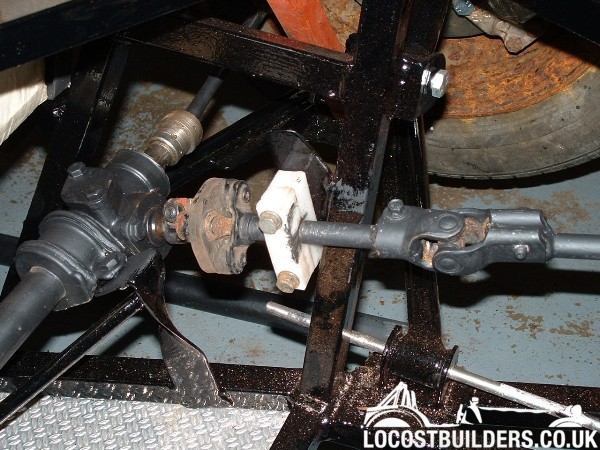

theres a mod somewhere for people that have an extra uj in there steering, does anyone have some pics of there dog leg please?

This is mine in an early state !
Rich

posted on 25/4/08 at 09:02 PM Reply With Quote
I've used 2 blocks of nylon which I clamped together and drilled to suit the column I then fitted it to a bracket on the chassis for support.
