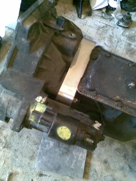

Hi, this is a bit off topic but hopefully someone can help.
I've been trying to get a vw tdi started in my mk1 transit. Got all the electrics working but then the starter just went 'clunk'.
Since then I've removed the starter and the glow plugs and still cant turn the crankshaft (g/b in neutral).
Is there anything I've over looked? atm I'm thinking the engine has to come to pieces
Andrew

Its a type 9 with an adaptor between the g/b and vw bellhousing. Have been in contact with crispin, I cant remember exactly but I think he went a different route with gearboxs.

Details below, may be of help?
Clutch Disc- custom: 23 splines for the type 9 and same diameter and thickness as a VW one.
Clutch cover- standard 1.9 TDI AHU
Clutch release bearing and lever- standard 1.9 TDI AHU
Clutch release bearing shaft- type 9 turned down to accept vw bearing
