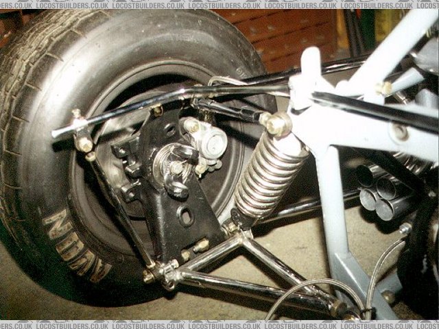

Terrapin_racing
| posted on 17/2/04 at 09:53 AM |
A common solution is to use a rosejoint SRE bearing attached to one of your existing wishbone bolts.
Cruise the photos on this site for ideas:
http://race-cars.com/carsold/hf.htm
