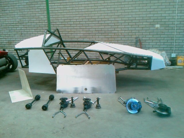

Hi Guys,
Heres a few pics of my bike engined build based on my first car (learnt a lot from all the constructive criticism. Im using a Sierra diff(3.36), made up some Haynes style uprights, VW starter for reverse, custom revers gear, cortina front uprights and Golf 3 steering.
In the process:
machining reverse gear and fitment of Discovery 1 rubber coupling as cush drive
Next on the list:

Some classy fishmouths there, do them by hand or some special tool?
Can't wait to see more
Gakes
posted on 12/10/09 at 05:33 PM Reply With Quote
Thanks for the nice comments.
I've learnt quite a bit messing around with my first car and not taking any shortcuts this time
flibble posted on 12/10/09 at 08:28 PM Superb! Some classy fishmouths there, do them by hand or some special tool? Can't wait to see more
Just a grinder and lots of time

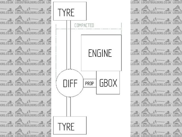

Im mounting the the engine longitudinally so as to use a prop instead of a chain drive. Not too keen on a chain snapping
The diff is mounted offset to the right with the engine just left of the centre. This will also keep most of the weight as low as possible and compact as possible which in turn will hopefully balance her a bit more.....in theory that is

For the tube notching I'm guessing he's using somerthing like this:
Which fits in a pillar drill and uses hole saws to cut the tube. I have a similar device and love it as it makes you look like a tube fitting genius.
lol. Honestly I just use a tape measure, marker pen and grinder.

Heres a diagram that illustrates my idea: Rescued attachment XO400 ENGINE BAY.jpg

When I look at tadltd's picture and your chassis it looks like it may be a tight squeeze? (bum to axle distance).

prop v. chain
Originally posted by nitram38
also using a prop makes the car longer
Not necessarily. I measured an actual Quaife & 'Busa chain setup with reverse, and then measured out a longitudinal 'Busa with differential. There's less than 1" difference in length. Either way, it's a tidy little package in the xO400 with lots of extra room.
I actually requested this design from Gakes, less for chain snap and more because I thought it could be reproduced at a lower price than the Quaife solution. Not that it's better, just as a proof of concept. Gakes filled in the details quite nicely, I think.

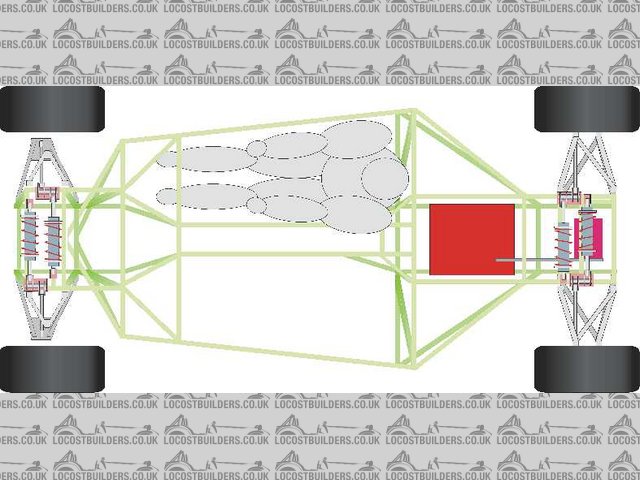

JUST IN MY HEAD busa mid engine
my idea for busa engined midi
only in a draw programme not in cad so its a bit basic.
locost front suspension and uprights from Rally designs and haynes rear suspension and upright from 3gecomponents so a major cost but worth it i think for tried and tested parts
sierra drive shafts and diff converted for chain drive, escort steering rack
nothing at all way out there or new really, this will be fully enclosed GRP composite bodywork

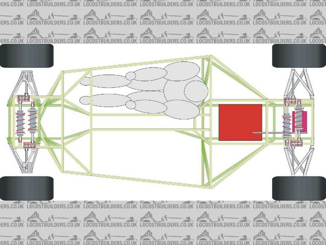

Great layout Aitch, just flip your front wishbones around I think it will help the Kpi.
I hope you get starting soon
lol id been looing into castor on another thread and had worked out i got this wrong after the assumption cortina uprights with steering arm horizintal and forwards, heres the corrected sketch
thanks gakes i could have been going off road and this pic been posted in three places although i realised you are the only person that pointed it out
