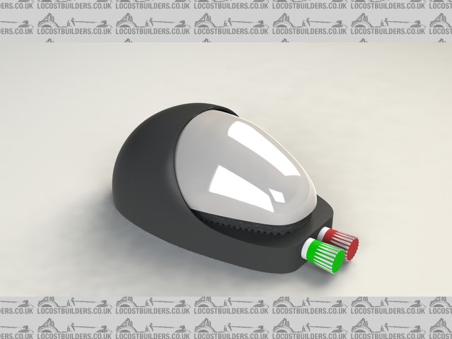

this is my latest creation.
done totally using surfaces, no extruding in this! Rescued attachment assembly rendered.jpg
