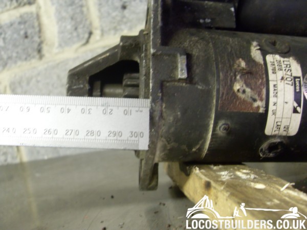

You will need to check the throw of the pinion.
My guess is it will be to long and jam. Most use the lucas lrs707 but there was a post from a guy last week who said his wouldnt throw out far enough.
Hows it compare with this one ?
http://www.locostbuilders.co.uk/upload/lrs707.jpg
This works in mine.
