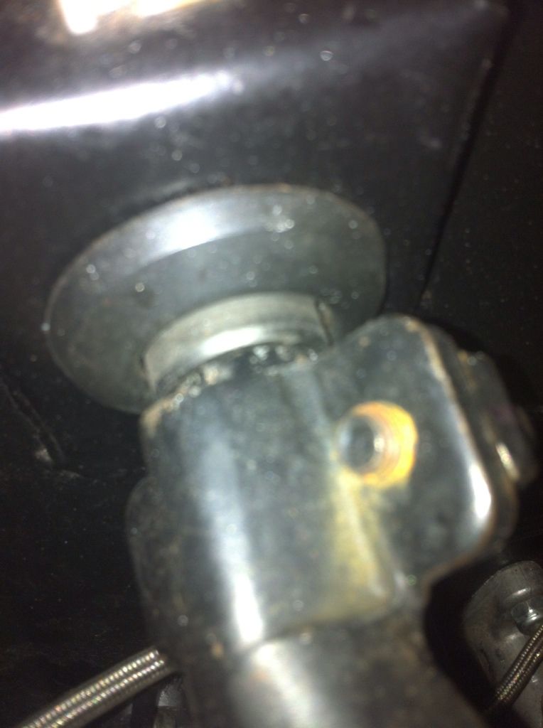

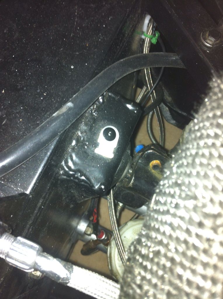

what steering column bearings are people using?
im wanting to replace my sierra setup with a custom column but want to have a proper bearing that goes through the bulk head
i think i may be restricted due to the bulkhead section as there may be enough width on in the bearing area
here are some bad pics of my current setup,
